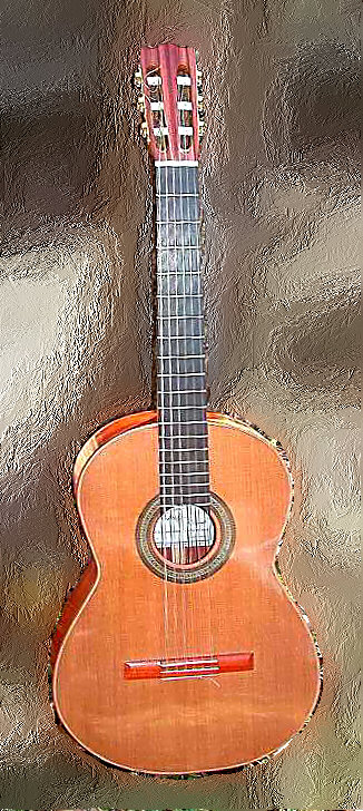

Michael McBroom's guitar, leanin' on a tree.
I still prefer the background soft or out of focus to "pop" the subject. (This ultra-quick example is a few notches below down-and-dirty when it comes to digitally finding the edges of the guitar, but you may see what I mean.)
Dennis
